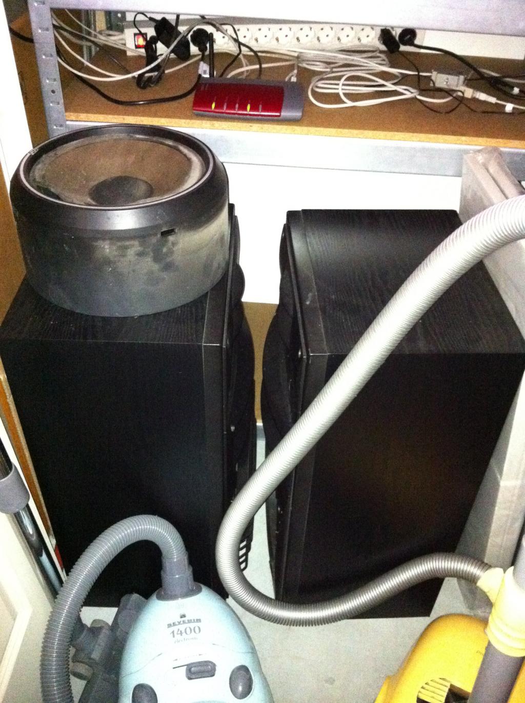

MessagePosté le: Mar 13 Mar 2012, 14:25    Sujet du message: JAMO Power 366 Répondre en citant
This is my second set of Jamo Power series. These are all original (Thank God!!) 366's. They need restauration, but only for the CBR suspension blocks and the foam on the woofers. These are still in storage in my shop/office as I have a set of Power 266 performing excellent!
With an Ohm meter I measured all units and they are all OK (no shortings). I have not yet heard them playing music...

MessagePosté le: Mar 13 Mar 2012, 14:33    Sujet du message: JAMO Power 366 Répondre en citant
Yes it is perfect! I am only missing one red lens for the overload protection indicators! After taking pictures I found the two from the left speaker behind the aluminum strip!!! Only the right speaker is mssing one lens...
I have found foam rings, but I still have to order them.... Time permits, I'm self employed working very, very long days... :-)

MessagePosté le: Mar 13 Mar 2012, 14:52    Sujet du message: JAMO Power 366 Répondre en citant
Here are two more images of their current state...

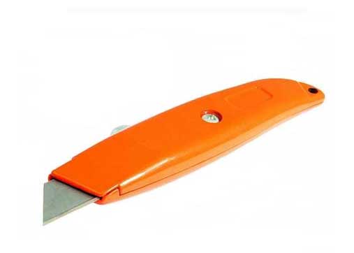

MessagePosté le: Mar 13 Mar 2012, 15:32    Sujet du message: JAMO Power 366 Répondre en citant
First you use a cutter like this one :
Put the blade between the woofer and the tube on the front. Then, after you did 360° with the cutter you shake the tube on the ground and the woofer will come down.
